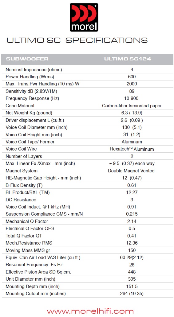

- Morel Ultimo SC124
Consistent with Morels philosophy, the Ultimo SC was designed to deliver innovative engineering resulting in extraordinary combination of audiophile bass quality and high power output at a great consumer value. The Ultimo SC employs some of the best technological features of the Ultimo subwoofer such as a gigantic 5.1” Hexatech™ External Voice coil (EVC™), a hexagonal-shaped aluminum coil wire (2-3 times thicker than standard subwoofers) that is used for accurate music reproduction and for superior durability and power handling. A highly efficient magnet system – DMM™ Double Magnet ferrite Motor that maximizes the magnetic field (over 90% efficiency).
The Ultimo SC subwoofer employs a unique hybrid paper-carbon fibre composite cone to achieve the extraordinary musicality in SQ application. Its chassis is composed of stamped steel and its power handling is 600WRMS.

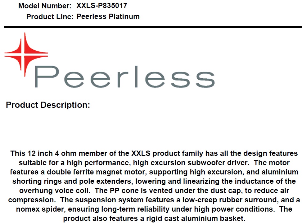

- Peerless Platinum XXLS
Название: Peerless описание.jpg
Название: Peerles техн.данные.jpg
